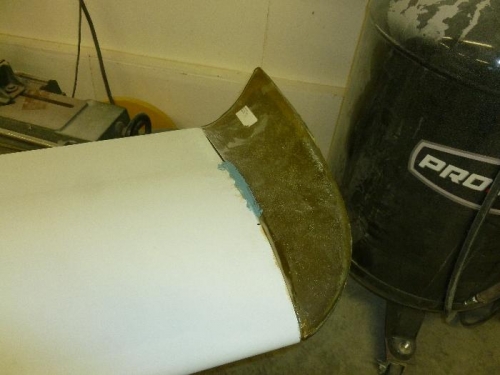

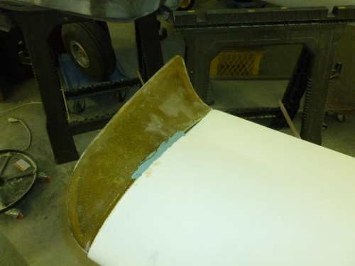

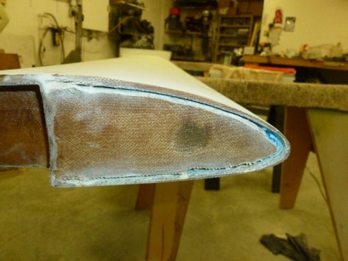

Canard tip installation
The die grinder did some dinging for me and I kept trial fitting the ends until it was ready for attachment. I used T88 and flox for the tip attachment and bondo to hold the low area in place. I will work on clearances and glass next.
Die grinder got things ready
Bondo is holding things in place
2nd side was faster
