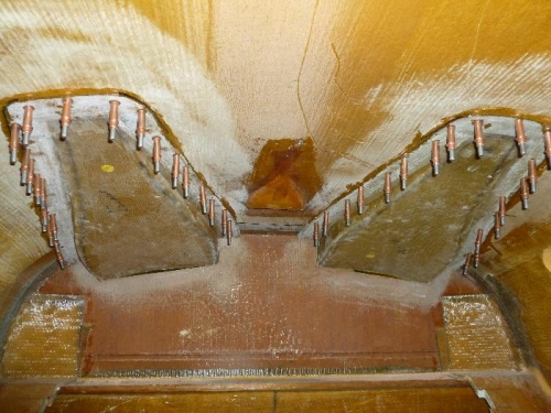

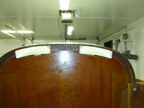

Brief Description:  In stalled NACA scoop
Had to cut a few times to get the fit I wonted. I notched the top back scoop flange so it would slide back into the fire wall. Sanded up everything and used structural adhesive to stick this in place. This is first time using clecos with the glass body. I will have to do lay-ups on the scoop from inside the fuselage to also hold it into place. The front of the scoop area will be cut out and transitioned to allow the smooth air flow from body to engine for cooling.
In place
In place
Fit was good
Fit was good
Still work to do here
