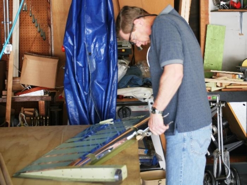

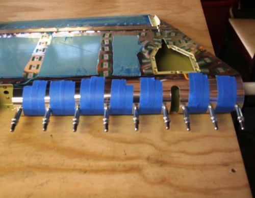

Today I rolled, clecoed and taped the Rudder Leading Edge. The blue painters tape ensures that when I pull out a cleco so that I can insert a blind rivet the leading edges don't move relative to each other. Yes, I know the clecos are there for that purpose but I've found it can be difficult to install/remove the clecos without the tape.
Rolling the Rudder Leading Edge Using Duct Tape and Wooden Dowel
Rudder Leading Edge Rolled, Clecoed and Taped
Closeup of Clecoed and Taped Leading Edge
