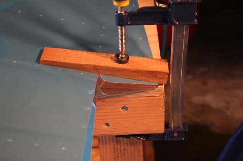

Brief Description:  Preparing the Left Elevator
After my success with bending the tabs on the Elevator Trim Tab I used the same technique on the Left Elevator tabs. Used my band saw to quickly make another set of blocks (thank goodness for scarp lumber in the garage) that I then clamped the skin between. If I had to do it again I think I would put a 2 x 4 between the skins to support the end that is off the workbench.
Bending the Left Elevator Tabs
Bending the Lower Tab Up
Bending the Upper Tab Down
