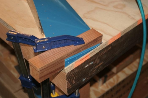

Used my bandsaw to fabricate two wedge shaped blocks that I clamped the Elevator Trim Tab between so that I could bend them square to the ends. I think the results turned out well.
