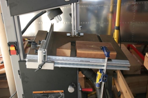

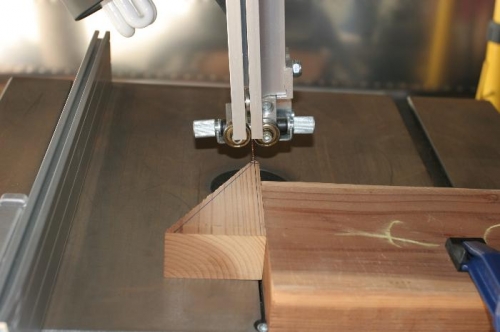

Prior to bending the end tabs on the Elevator Trim Tab I used my band saw to cut some scrap lumber into a form block. This was a little tricky because the Trim Tab tapers from one end to the other. So I adjusted my band saw to cut the form block with a taper.
