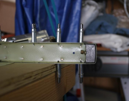

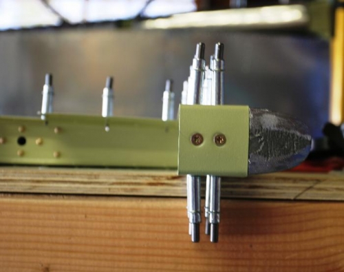

Once the Right Elevator Skeleton was installed in the Right Skin it was time to preliminarily install the Right Elevator Lead Counterweight. Images 1 and 2 show the counterweight loosly held in place with two screws and the end strap.
Right Elevator Lead Counterweight loosely Held in Place with Screws
