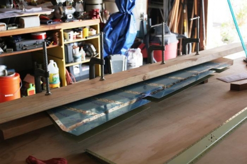

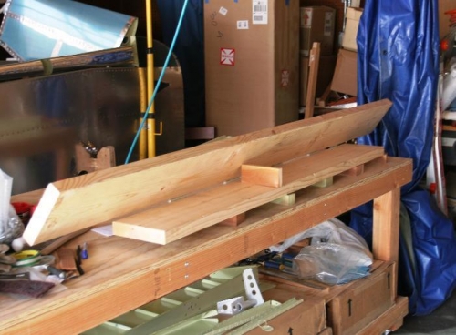

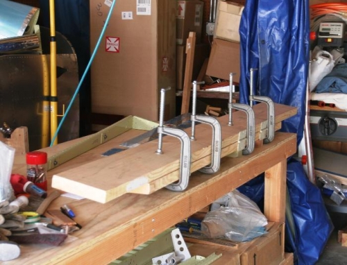

Vans's manual calls for fabricating a tool from 2 x 6 lumber to ensure that the Elevator Trailing Edge is straight and not rounded and Image 1 shows the tool I bult. Spent a while looking for a straight 10 foot long 2 x 6. I cut it into two pieces - one four feet long and one six feet long so that I would have an overhanging edge to use as a handle. But I didn't develop much force with my bare hands so I resorted to 4 large C-Clamps. I gave both the Right and the Left Elevators the same treatment.
Tool Made for
Tool Made for "Crimping" the Elevator Trailing Edge
Right Elevator Trailing Edge Getting
Right Elevator Trailing Edge Getting "Crimped"
