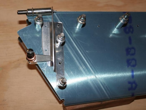

Match drilling the Elevator Trim Tab. I wanted to be sure that the two-piece control horn was correctly aligned so I clecoed it as shown in the attached images. One cleco through the pivot point at the front and one cleco-style clamp holds the control horn flange for match drilling to the Trim Tab skin.
Match Drilling the Elevator Trim Tab
Match Drilling the Elevator Control Horn
