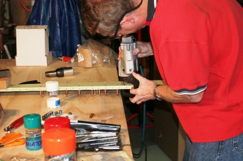

Manual Reference:  Section 6
Brief Description:  Riveting the Vertical Stabilizer
Now assembling the Vertical Stabilizer. In Images 1 thru 3 I'm using my pneumatic rivet squeezer to rivet the VS-803PP Aft Spar to the VS-808PP Aft Spar Doubler. The hinge brackets were also riveted in place at the same time.
