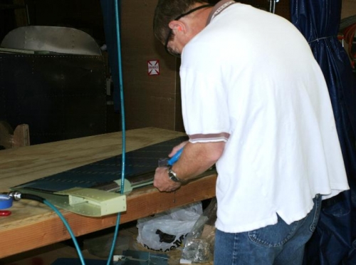

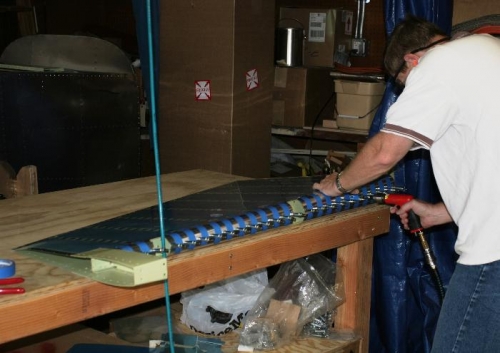

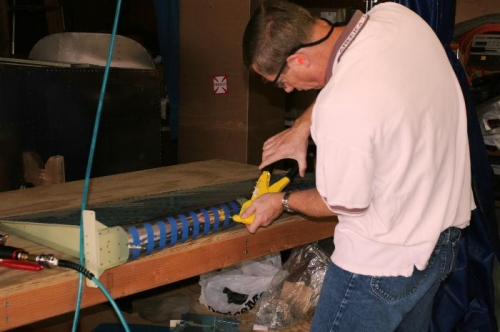

I drilled the holes in the leading edge starting at the top of the rudder and worked my way to the bottom. Then I removed all of the clecos and tape and deburred all of the drilled holes. Not the easiest thing on the back side of the skins. After deburring I re-clecoed and taped the leading edge and proceded to blind rivet the leading edge. I worked each section of the leading edge independently starting at the bottom of the rudder. I started riveting each section in the middle and worked my way out to the ends alternating sides.
Drilling the Bottom Section of the Rudder Leading Edge
Deburring the Holes Drilled in the Rudder Leading Edge
Blind Riveting the Leading Edge of the Rudder
