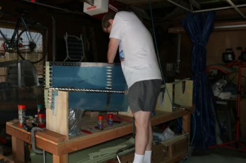

With the Horizontal Stabilizer Skins and Skeleton held by the fixture I made it was time to start riveting the HS-702 forward spar to the HS-707 and HS-708 nose ribs. The blind rivet pulling tool I received in my Avery Tools tool kit worked quite well in the confined space. I stood on a small, three step step-stool so I was tall enough to comfortably reach inside the Horizontal Stabilizer.
