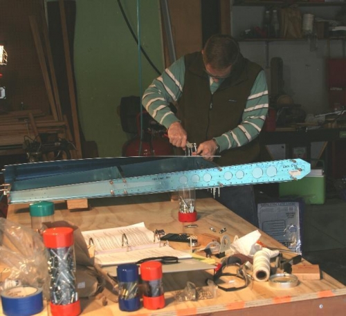

Date:  1-25-2008
Number of Hours:  1.00
Manual Reference:  Section 6
Brief Description:  Drilling the Vertical Stabilizer

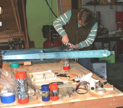

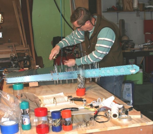

Disassembled Vertical Stabilizer sturcture and deburred all matching holes and cleared chips. Then re-Cleco'd the Vertical Stabilizer structure together and cleco'd the VS-801PP skin in place in preparation for match drilling the skin to the structure.
Clecoing VS-801PP Skin to Underlying Structure
