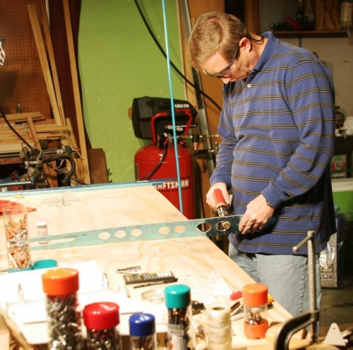

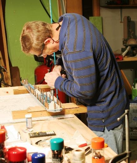

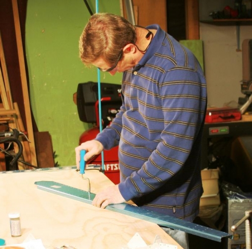

Brief Description: Drilling the Vertical Stabilizer
Cleco'd the VS-808PP Spar Doubler to the VS-803PP Rear Spar then cleco'd on the VS-410PP, VS-411PP, and VS-412PP hinge brackets. Drilled all holes in the Spar, Spar Doubler and hinge brackets. Disassembled and deburred all parts.
