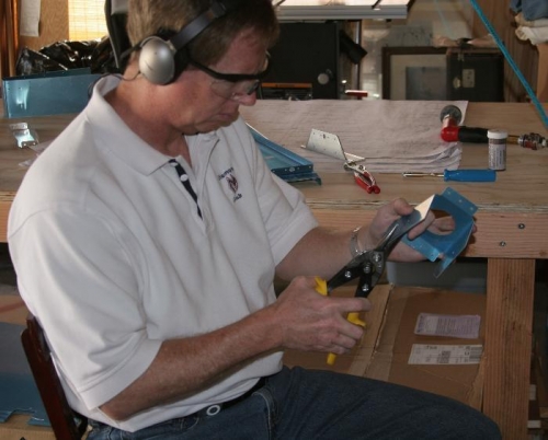

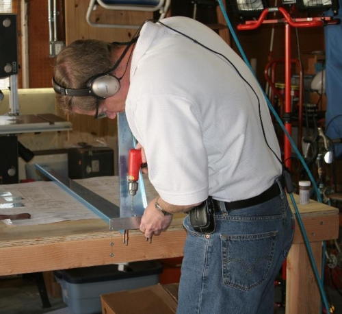

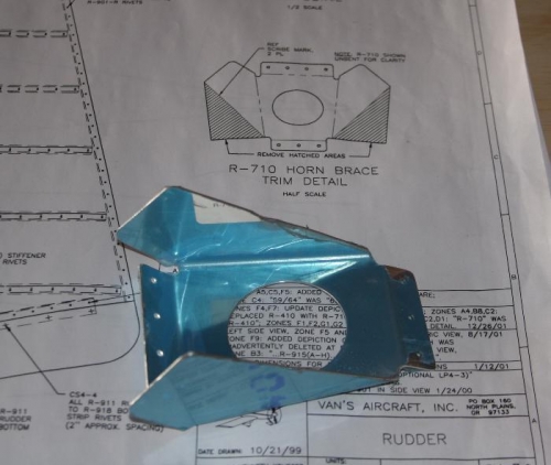

Trimmed excess material from R-710 Horn Brace. Deburred R-710 Horn Brace using Scotchbrite wheel, Vixen file, and Emoy cloth. Match drilled R-902 Spar, R-405PD Rudder Horn and R-917 Shim.
Trimming R-710 Horn Brace
Trimmed R-710 Horn Brace
Match Drilling R-902, R-405, & R-917
