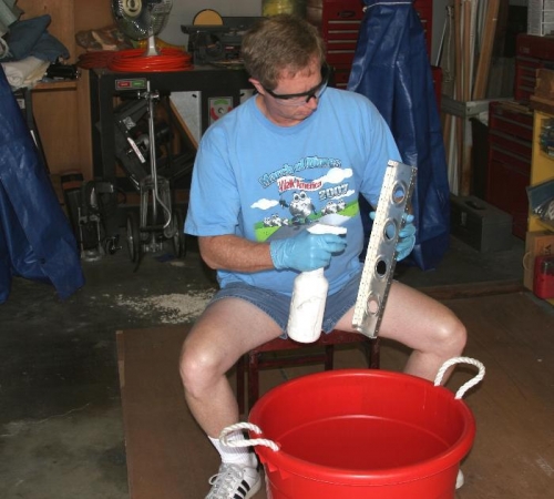

After a lot of reading I decided to try using PreKote surface prep instead of Alodine. My reasoning is that the PreKote is much safer to the environment - I live in California and I don't want to deal with hazzardous waste disposal - and probably not much more work.

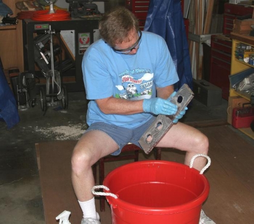

The process is simple enough. Spray PreKote onto the surface enough to wet it completely, scrub with a ScotchBrite pad (pink) until you generate a good lather. Spray again, scrub again then rinse with clean water and air dry. I decided to work over a large plastic tub to catch the drippings and minimize the mess in my garage.
Decided to Use Prekote Instead of Alodine
Spray Onto Part
Spray Onto Part
Scrub Part with ScotchBrite Pad
