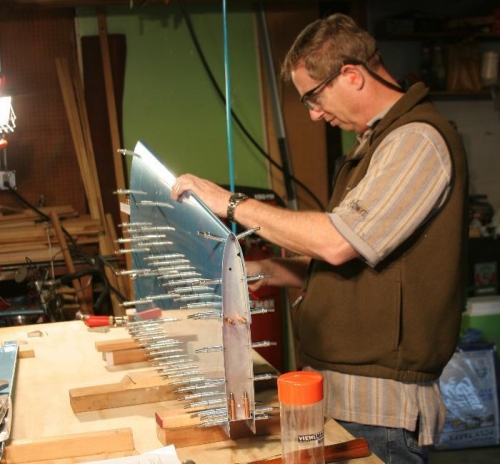

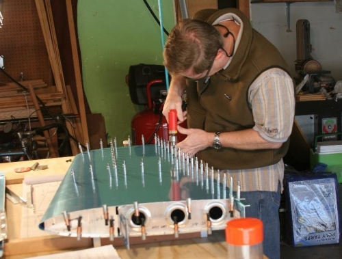

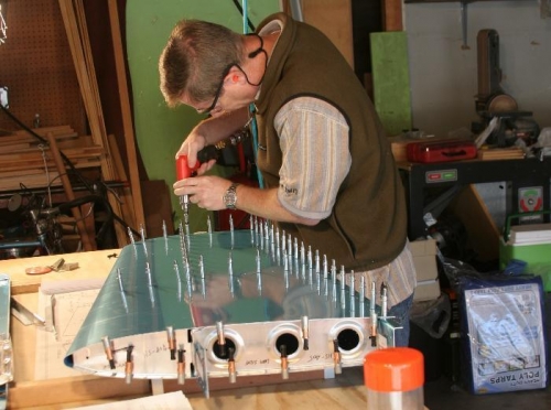

Drilled LH HS-601PP skin to underlying structure, including HS-706 Tip Rib, HS-707 Nose Rib, HS-708 Main Rib, HS-702 Fwd Spar, HS-603PP Rear Spar, HS-404 Nose Rib and HS-405 Main Rib.
Match Drilling LH HS-601PP Skin to structure
