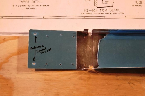

Trimmed the inboard ends of the HS-702 Front Spars removing the upper and lower flanges back to the 1/4" diameter relief holes. Bent the end tabs on both spars per the detail view on the upper right of drawing #3. Dimpled the endmost holes.
Trimmed End of the HS-702 Front Spar
