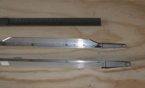

Used a Vixen File and the Scotchbrite wheel to smooth the bandsaw trimmed edges to a smooth finish. In the end decided that I had cut too close to the final dimension with the bandsaw - after finishing the edges the final parts were well inside the lines originally marked. Ordered new parts from Van's Aircraft.
HS-710 and HS-714 after trimming with bandsaw
