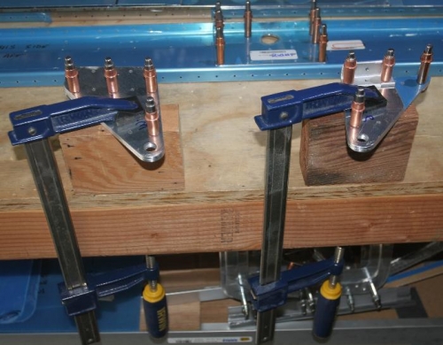

Only just managed to get started today before some of the neighborhood kids stopped by asking me to help them make some rubber band guns. Image 1 shows how I set up the Aileron Brackets for match drilling. I clamped them to some scrap pieces of 2x4 so that the clecos wouldn't be in contact with the work bench. Image 2 shows me match drilling the Aileron Brackets on the 2x4 blocks and Image 3 shows me match drilling the Aileron Brackets to the Aft Spar
Aileron Brackets Clamped to Blocks for Match Drilling
