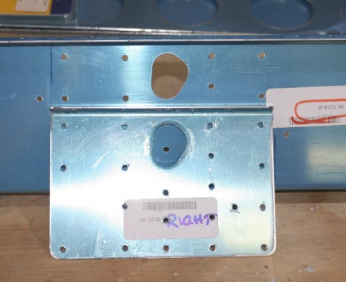

Date:  8-20-2011
Number of Hours:  4.00
Manual Reference:  Aft Spar
Brief Description:  Cutting the Mid-Spar Aileron Bracket Control Rod C

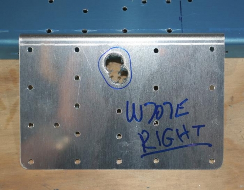

After marking the location and shape of the clearance cutout for the aileron control pushrod onto the aft spar mid-span Aileron Doubler I set up my Unibit in my Drill Press. Image 1 shows the marked mid-span Aileron Doubler clamed onto the work table. Image 2 shows the 2 overlapping holes cut by the Unibit. Image 3 shows the final hole after some hand filing using my finishing files.
Using Drill Press with Unibit Tool to Drill Initial Holes
Overlapping Holes Drilled Using the Unibut
Finished Clearance Hole After Filing to Shape
