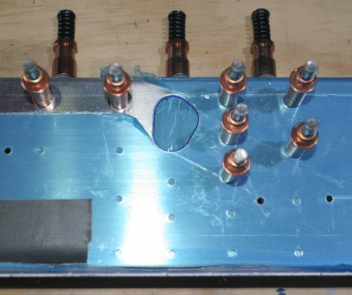

Image 1 shows the left mid-span Aileron Doubler clecoed in place so I can mark up where to cut the relief hole for the aileron control pushrod. Image 2 shows me match drilling the left outboard Aileron Doubler using two of my cleco jars to help hold the z-section upright. Image 3 shows me match drilling the left Aft Spar Aileron Gap Seal.
Marking the Left Mid-Span Doubler for the Aileron Pushrod Clearance Hole
