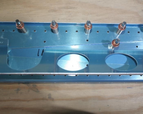

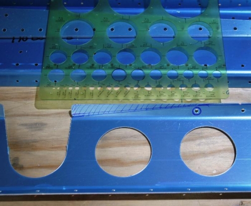

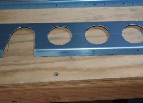

Back on July 31st I trimmed the Aft Spar Flap Supports per the toolong marks supplied and decided I didn't like the edge distance to the first rivet hole so I decided to scrap them and ordered two new parts from Vans. Image 1 shows one of the new Aft Spar Flap Supports with the minimum edge distance I wanted to remain marked on the part. I then clecoed the Flap Support to the Aft Spar as shown in Image 2 and marked where the edge of the doubler met the Flap Support. Image 3 show the material I plan to remove, using my band saw this time, in the crosshatched area.
New Aft Spar Flap Support with Edge Distance Marked

New Aft Spar Flap Support Clecoed in Place for Marking

New Aft Spar Flap Support Marked up for Trimming
