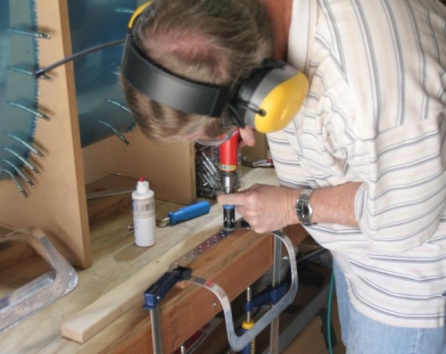

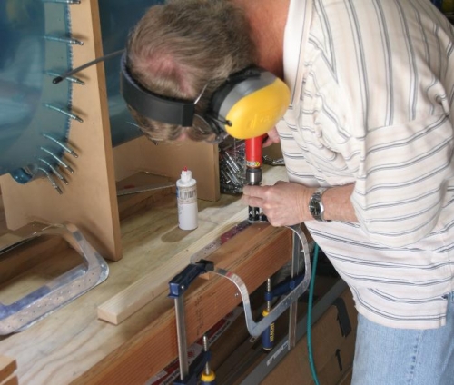

After trimming the excess off the frame I had to countersink the upper spacer so that the dimpled Leading Edge Skin would have someplace to fit into. Images 1 and 2 show me using my micro-stop countersink cage.
