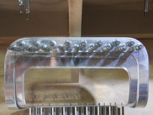

Brief Description:  Preparing for Landing Lights

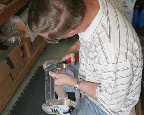

In Image 1 you can see that I have clecoed the Landing Light Lens Frame together as a unit to see how well the edges line up. Where they don't line up there is excess material that represents excess weight. Airplanes only fly because they are light. So I want to remove the excess material. I tried using my metal snips to cut the excess off (Image 2) but found that the 0.050 material was very difficult to cut so I ultimatly used my files. Image 3 shows me using a file to clean up the inside edge of the part of the frame that the Landing Light Lens will be fastened to.
Landing Light Lens Frame Clecoed to Show Excess Material
Using Metal Snips to Remove the Excess Material
