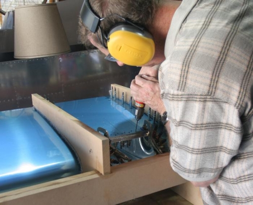

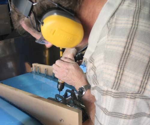

Brief Description:  Preparing for Landing Lights

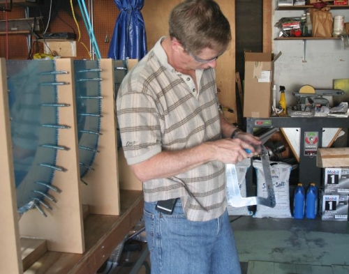

Images 1 and 2 show me match drilling the lower leading edge surface to the Landing Light frame. Note in Image 2 that as I move accross the frame I immediately put a cleco in the drilled hole (from the inside so it's easier to drill) to keep the frame in place. Image 3 shows that no matter how many holes you drill, you're not done until you deburr each hole.
Match Drilling the Lower Surface of the Landing Light Lens Frame
And the Always Fun Deburring
