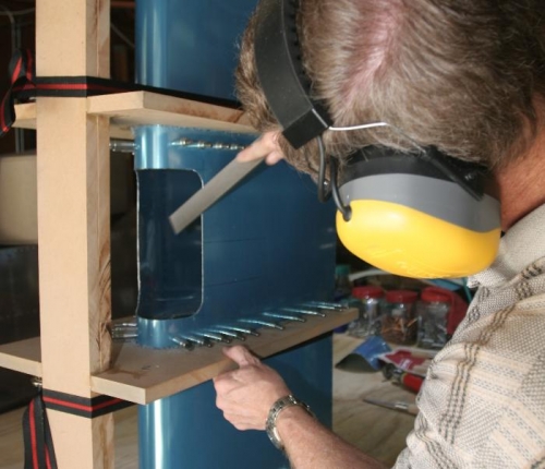

Brief Description:  Preparing for Landing Lights

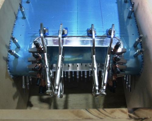

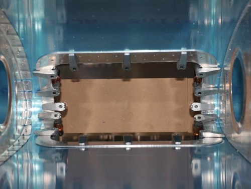

After the Landing Light Lens cutout was roughed out using the hacksaw I filed the edges smooth using my files. Image 1 shows me using my Vixen file on one of the straight edges. Image 2 shows me doing a preliminary fit of the Landing Light Lens Frame in the cutout. from this I learned that I needed to do some additional filing on the inside edges of the frame spacers to match the cutout on the skin. After I had the edges matching up well, I matched drilled and clecoed the upper surface of the frame to the upper surface of the leading edge. Image 3 shows the frame with the upper surface clecoed in place and the bottom clamped in place and ready for match drilling.
Filing the Edges of the Landing Light Lens Cutout

Using Side Clamps to Locate the Landing Light Lens Frame
Clamping the Landing Light Frame Prior to Match Drilling
