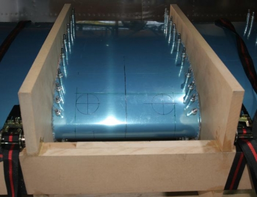

Date:  6-12-2011
Number of Hours:  1.50
Manual Reference:  Lighting
Brief Description:  Preparing for Landing Lights

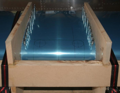

Time to mark up the right Leading Edge Skin for the Landing Light Lens cutout. Found the center of the landing light bay and then marked off the width of the lens on either side. Used a circle template to draw in the 1-inch radius corners. Images 1 and 2 show the marked up skins.
Upper Surface of Right Leading Edge Marked up for Lens Cutout
Lower Surface of Right Leading Edge Marked up for Lens Cutout
