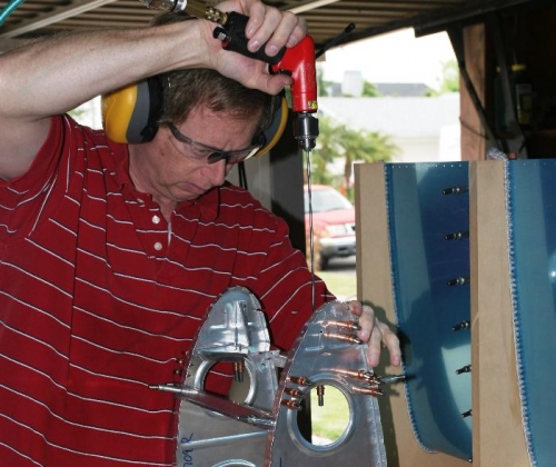

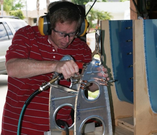

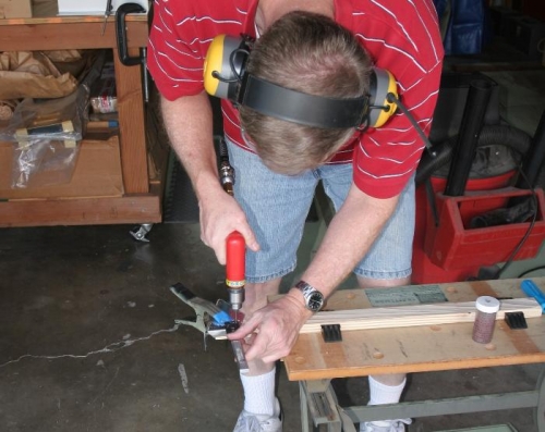

Images 1 and 2 show me match drilling the opposite side Support Bracket to the Outboard Rib. Image 3 shows me using a Nutplate (or is it Platenut?) drilling jig to make provisions for nutplates that will secure the Landing Light Mounting Bracket to the Support Brackets.
Drilling the Opposite Side Bracket
Using a Nutplate Drill Jig to Drill the Side Supports for Nutplates
