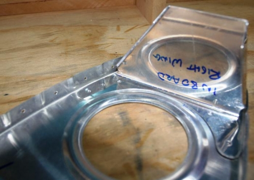

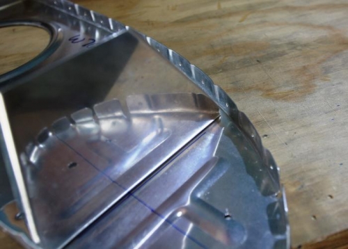

Just like for the left wing Landing Light Brackets I need to trim the inboard Right Wing Landing Light Bracket to ensure there will be clearance for the bucked head of the 3/32" flush head rivet that fastens the Leading Edge Skin to the rib. Images 1 and 2 shows the clearance before triming. Image 3 shows me using one of my fine tooth files to remove a little more material.
Right Wing Inboard landing Light Bracket Clearances
