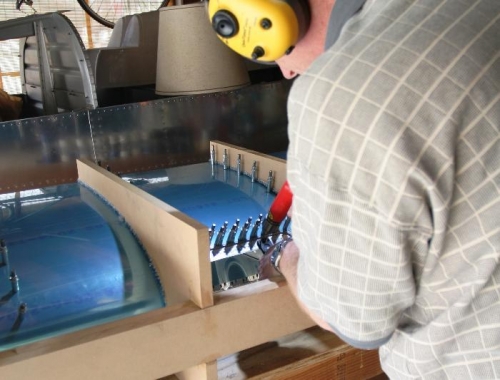

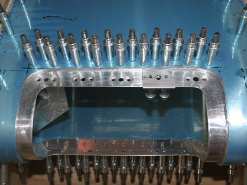

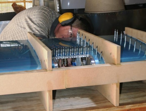

In the home stretch now for the Left Landing Light. Now working on the lower surface, in Image 1 I used my Platenut Drill Jig to drill the Platenut rivet holes. Image 2 shows that by reaching in from the spar side of the Leading Edge I install can the Hole Oversizing Tool that I made. I cleco the tool in place from the inside so that there is very little of the Cleco sticking out to cause trouble when I drill the fastener hole. Now when I use my #10 screws to fasten my Landing Light Lens in place there is some clearance for the screw to move when the different thermal expansion rates between Plexiglass, steel and aluminum occur.
Drilling Platenut Holes Using the Platenut Drill Jig
Installing Hole Oversizing Tool from the Inside of the Leading Edge
Hole Oversizing Tool Cleco'd in place
