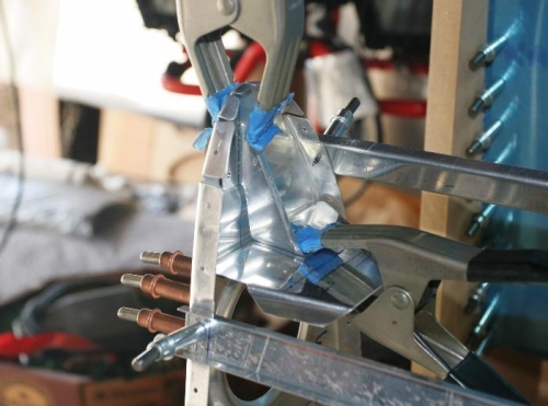

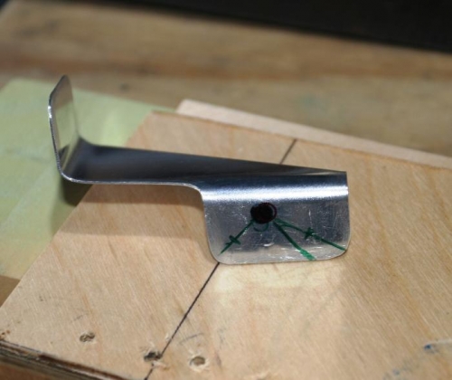

Image 1 shows the Sharpie mark for the Rib Tooling Hole and where I've decided to drill for the rivets to maintain 2D + 1/16" edge distance. Image 2 shows how I've used a double layer of the same thin plywood I made the Landing Light Lens Form from to support the Strut while I drill the two rivet holes. Image 3 shows the Strut clamped in place so I can drill the first of two holes into the Inboard Bracket. Note also that in Image 3 you can see where I have bent the edges two strips of Aluminum I was using to make the whole assembly stiffer on the bench. Without those bent up edges the 0.025 Aluminum was just too flimsy.
Sharpie Mark on Strut Indicating Where Rib Tooling Hole Falls on Strut Tab
Preparing to Pre-Drill Rib Holes on Strut Tab
Strut Clamped in Place Between Rib and Bracket
