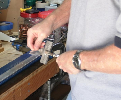

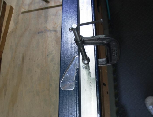

Continuing with the bends, Image 1 shows bend number 2 that was also done using the bender brake. It was such a short length that only one C-Clamp was needed. The last bend had to be done using my Hand Seamer from Avery Tools. I can't use the Bender Brake because the bend is in the opposite direction from the previous two bends. I've deliberately made the bends in these directions so that water can't get trapped in pockets - it will be more apparent when I cleco the assembly together again. Image 3 shows me making that last bend. This is in some ways the most challenging bend because it needs to be square with the other two but it is in the oppposite direction.
