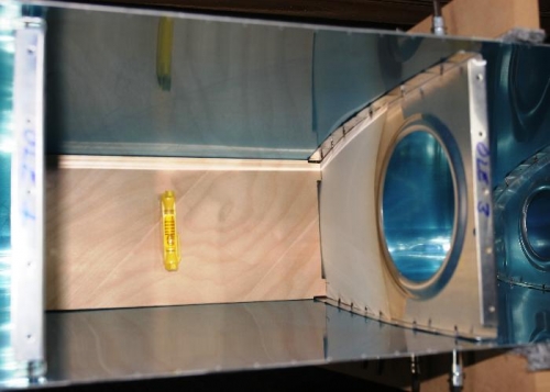

Brief Description:  Preparing for Landing Lights

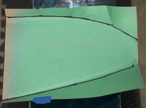

Now to work out some support structure for the Landing Lights. First, I'm going to try to make a template of the inside of wing skin. Image 1 shows a piece of construction paper pushed down onto the rib. Image 2 shows where I used a Sharpie pen to mark the inside of the Leading Edge. Image 3 shows my first attempt at Landing Light Support Structure. I used some of the left over plywood I made the Landing Light Form from. To make sure it was located square with the world I set a small bubble level on the plywood as shown in Image 3.
