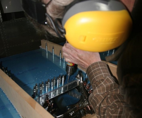

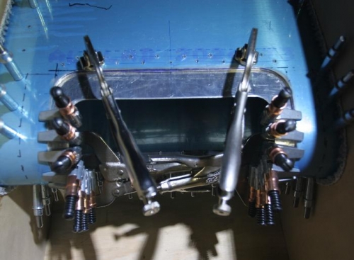

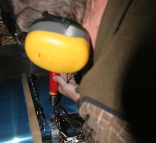

Ordered 10 more deep jaw cleco's from Aircraft Spruce (who had the best price this week) and set up to match drill the Landing Light Support Frame to the Left Leading Edge. The ready-to-drill installation is shown in Image 1. Images 2 and 3 show me match drilling the Support Frame to the Leading Edge. I started from the left side and worked my way accross, putting in 5/32 clecos as I went.
Landing Light Suppport Frame in Place Ready for Match Drilling to Left Leading Edge
Match Drilling Landing Light Support Frame to Left Leading Edge
