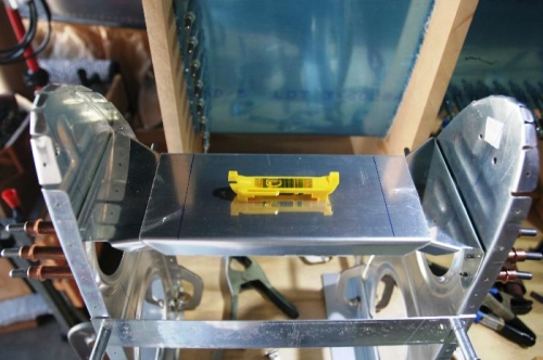

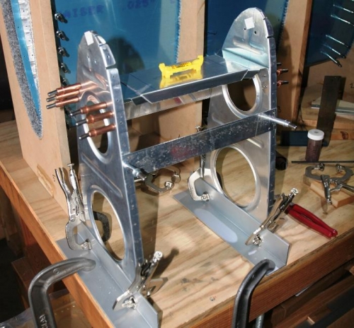

Brief Description:  Preparing for Landing Lights

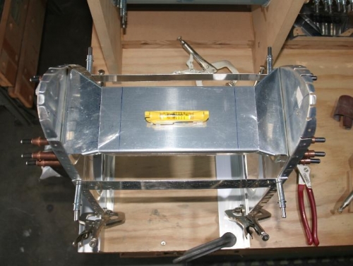

Wanted to show that I managed to get the Inboard and Outboard brackets installed sufficiently square that they are not quite 1/8 degree off from level (or very nearly parallel with the main spar) and that tells me I ought to be able to adjust them so they converge at a spot in front of the airplane. Image 1 is looking from below the wing and up, and Image 2 is almost straight ahead of the airplane. Image three is to show that I've cleco'd on two more strips of 0.025 Al sheet to help hold the parts square.
Inboard and Outboard Brackets are within 1/8 of a degree of level
Overall View Showing Added Strips of 0.025 Al to Make the Assemby More Stable on the Bench
