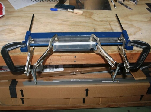

In addition to the two side brackets I need to fabricate a center bracket that will span between the two side brackets. The mounting bracket supplied by AeroLEDs with the landing light will bolt to this bracket. It won't be much more than a straight piece of 0.025 aluminum sheet with flanges top and bottom. Image 1 shows me about to bend the second flange on the bracket and Image 2 shows me in the act of bending the flange on the bracket. Image 3 shows me match drilling Outboard Bracket to the Outboard Rib.
My Bending Brake Set Up to Bend a 2nd Flange
Bending the 2nd Flange on the Landing Light Mounting Plate
