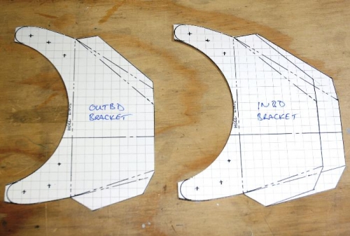

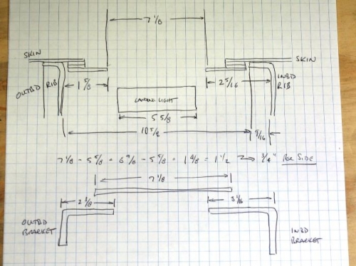

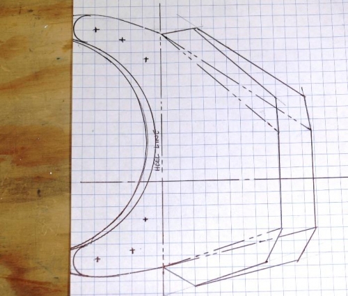

I wasn't satified with the previous brackets so I decided to start again from scratch and get serious this time. Image 1 is my hand sketch that shows the principle dimensions of interest for the installation. I wanted the landing light (by AeroLEDs) to sit in the middile of the cutout with some access on either side so I could get to the mounting screws that support either end of the light. My brackets need to be different lenghts for each side as the inboard bracket fits inside the rib and the outboard bracket fits on the outside of the rib. Image two is the 2-D line draeing I made of the brackets. I took this drawing to Kinko's and had them copy it onto some cardstock. I had 5 copies made and then I cut out two bracket templates, shown in Image 3..
Sketch Showing the PRinciple Dimensions of the Installation
2-D Line Drawing of the Brackets
Outboard and Inboard Bracket Templates
