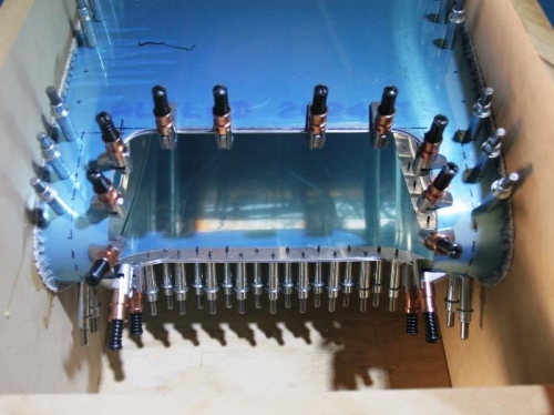

Brief Description:  Preparing for Landing Lights

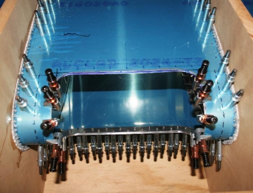

After match drilling the upper Leading Edge to the Landing Light Lens Shim I made a preliminary installation of the shims into the Leading Edge. As shown in Image 1, the lower edge of the shims needs to be trimmed a little more. This is because the shims are being curved around the inside of the Leading Edge and I intentionally left a little extra material so that I could "match file" the parts. Image 2 shows me with the Vixen file removing a little more material from one of the shims and Image 3 shows that I still have more to remove .
Preliminary Landing Light Lens Shim Installation
Removing a Little More from the Lower Edge of Landing Light Lens Shim
