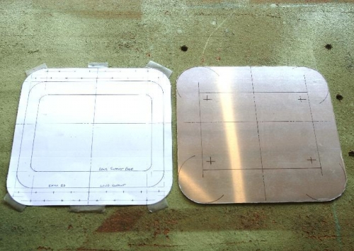

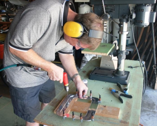

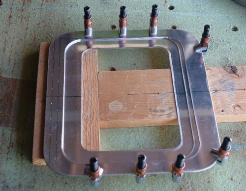

Image 1 shows my two Landing Light Mounting Frames marked up and ready to have the centers removed. Image 2 shows one of the Mounting Frames with the center cut out (using the pneumatic nibbler) and the edges cleaned up and clamped together with a set of 0.050 frames so they can be matched drilled together. Image 3 shows me match drilling the frames along the top edge.
Two Landing Light Lens Mounting Frames
Aligned Frames Clamped Together and Ready for Drilling
Match Drilling the Frames Along the Top Edge
