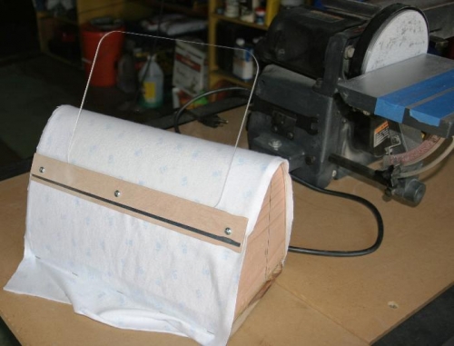

Manual Reference:  Lighting
Brief Description:  Preparing for Landing Lights
Time to fabricate a test article. The data I got from the internet says that the Plexiglas will shrink when it is heated and softened and since I didn't know ho much it would shrink I decided I need to make one to try out the form, the process, and see how much it shrank. Image 1 shows the peice of test Plexiglas inserted into the retainer on the form. Image 2 shows the form and Plexiglas right after they went into my oven set for 310 degrees F. Image 3 shows the Plexiglas after about 5 minutes in the oven - it has already started to droop. (Appologize for the dirty window on my oven).
Test Plexiglas Landing Light Lens Inserted into Leading Edge Form Retainer
Test Pelxiglas Lens in the Oven
Test Pelxiglas Lens in the Oven - Now Drooping
