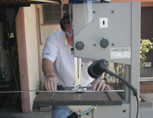

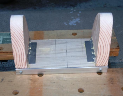

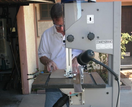

One of the issues I had with the original form was that I had to hold the hot-water-soaked 3/32" plywood on both sides while trying to get the band clamps in place on the edges. Just like hanging wallpaper, two hands just weren't enough. So I decided to add a retainer to the new form. To make the retainer I simply cut a piece of 3/32" plywood the width of the form (12 inches) and 5/8" wide. Over the top of this would be a piece of 1/8" x 1" aluminum strip. The added 3/8" height of the aluminum strip would trap the yet to be hot-water-soaked 3/32" plywood between the aluminum strip and the 2x8 forms and retain one end while I then used both hands to form the 3/32" plywood around the forms. Image 1 shows me cutting the 3/32" plywood shim, Image 2 shows me cutting off a section of the 1/8" x 1" aluminum strip and Image 3 shows the partially completed form with the retainer installed.
Cutting Shim from 3/32
Cutting Shim from 3/32" Plywood
Cutting Skin Retainer from 1/8
Cutting Skin Retainer from 1/8" Aluminum Strip
Partially Assembled Leading Edge Form Showing Skin Retainer Installed
