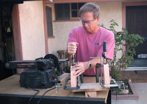

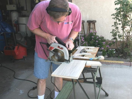

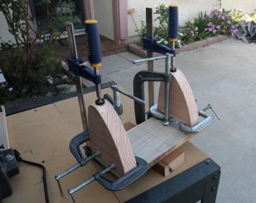

After cutting out and sanding the 3 new leading edge forms from 2x8 material I cut some of the remianing 1x8 poplar for a base. Image 1 shows me cutting off a piece from the original poplar board. This time I decided to glue the 2x8 leading edge forms to the base and to keep the forms at 90 degress to the base I cut some short lengths of the 1x1 aluminum angle I had used previously to drill the trailing edge of the rudder I used Elmers Wood Glue to glue the 2x8 forms to the 1x8 base and Gorilla Glue to glue the 1x1 aluminum angle to the 2x8 forms. I them used a mixture of clamps to secure all of the different pieces in place. Image 2 shows me applying the final clamp to the assembly and Image 3 shows an overall shot of the clamped assembly.
Using Circular Saw to Cut Base for New Plexiglas Form
Clamping the new Form Skeleton While the Glue Sets and Dries
No Skimpin on Clamps Here
