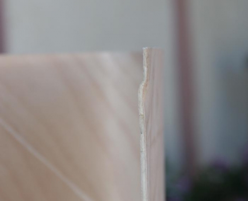

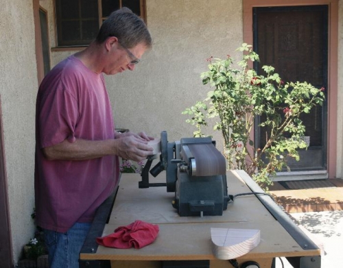

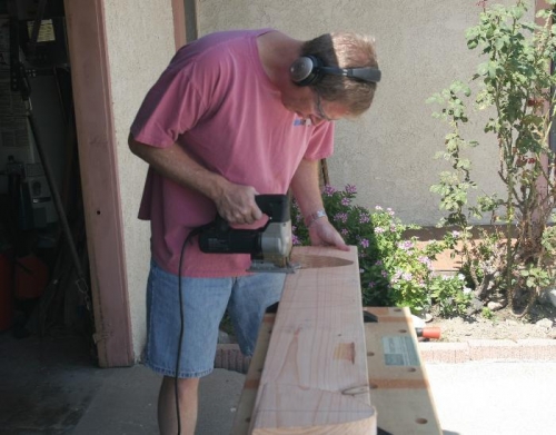

Keeping a wet kitchen towel draped over the plywood for 48 hours did indeed allow it to relax a bit more and get pulled down tighter by the two band clamps so I removed the wet towel and allowed the plywood to dry. When I removed the band clamps on Friday, I discovered that my skeleton having leading edge shapes that were only 3/4" wide was not entirely cpmpatible with band clamps that were 1 inch wide. Where the fabric straps were not supported by the poplar forms the plywood was distorted. This is shown in Image 1 below. Probably not an issue because my lense will only be 8 3/4" wide compared to the 12" width of the form, but since I had plenty of 3/32" plywood left I decided to try again - this time I would use some pine 2 x 8 to form the leading edge shape. I re-used the same template I used to draw the leading edge shape on the poplar. Image 2 shows me cutting out the new forms from 2 x 8 lumber. Just like the first time I made three shapes and will use the best two. Image 3 shows me sanding one of the 2 x 8 shapes. Something I learned was that the dirrection the disk sander is turning is important. Trying to sand on the side of the disk that was rotating up from 3 o'clock towards 12 o'clock I had to fight the machine to keep the wood on the sanding platform. Sometimes it would slip and put a gouge into the wood. On the opposide side, where the disk was rotating from 12 o'clock down to 9 o'clock was much easier.
Band Clamp Straps wer Too Wide for My Poplar Forms
Cutting Out New Leading Edge Forms from 2x8 Lumber
Using Disk Sander to Finish New 2x8 Forms
