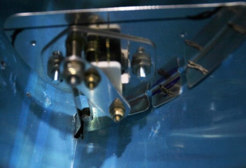

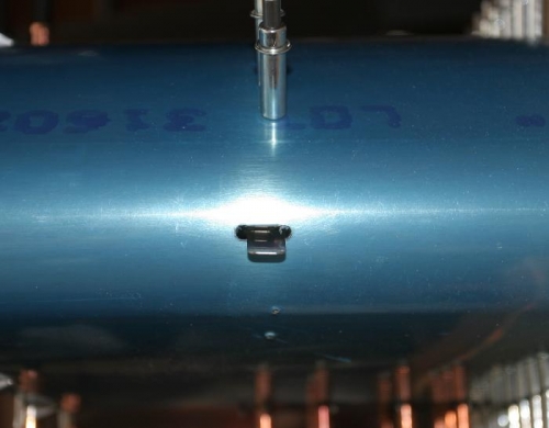

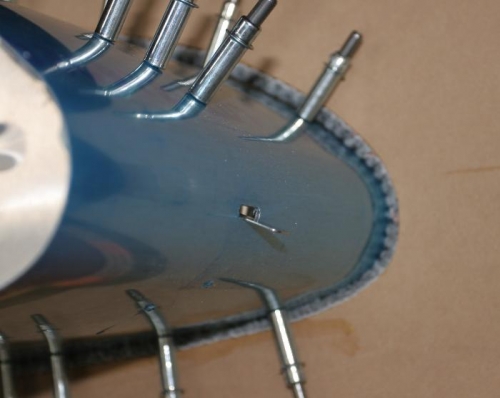

I clecoed the Upper Stall Warning Bracket and Switch Assembly into the leading edge and this installation, shown in image 1, looks much better. The bend in the vane is just inside of the leading edge and the roller is clear of the slot so it can be actuated by the vane. Images 2 and 3 show the vane extending out of the leading edge of the wing where it can be acted upon by the airstream. The next task will be to final trim the upper and lower Stall Warning Brackets to remove weight.
Upper Stall Warning Bracket and Switch Assembly Clecoed into Leading Edge

Stall Warning Vane Extending Out from Leading Edge
