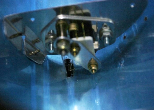

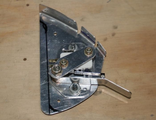

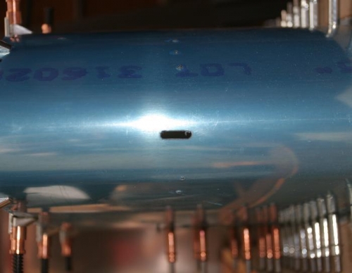

The finished Stall Warning Vane Slot, shown in Image 1, now allowed me to cleco the lower Stall Warning Bracket and Switch Assembly into the leading edge of the wing. Shown in Image 2 it fits but, if you look closely, you can see that the roller on the end of the switch actuation lever is trapped in the slot. This means it will not move off it's present position and will not provide any useful readings. So onto the upper Stall Warning Bracket. Image 3 shows the Stall Warning Switch Assembly installed on the upper bracket.
