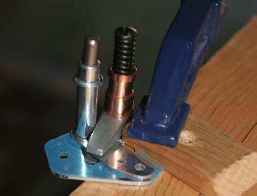

Today I worked on the new Stall Warning Sensor Switch Mouning Plate. I wanted to assemble and install the Stall Warning Sensor into the clecoed leading edge so I could determin whether the switch would be installed on the upper or lower half of the bracket. I decided to try the lower bracket half first on the theory that the holes for this bracket were closest to the locating holes for the tool and therefore most likely to be correct. In the precess of countersinking the Switch Mounting Plate for the pivot screw I made the countersink too deep so I've ordered another plate from Vans.
Stall Warning Sensor Switch Mounting Plate and Switch Keeper Plate Secured to Bench for Drilling
Switch Adjustment Pivot Hole Countersunk
Switch and Tab Assembly Temporarily Installed on Lower Mounting Bracket
