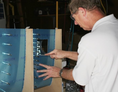

Brief Description:  Preparing for the Stall Warning Kit

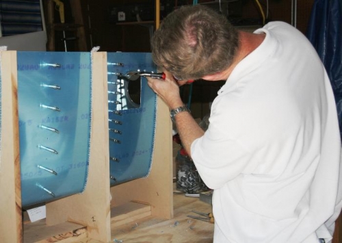

Using the metal snips (green handles for straight-to-right turn cuts, red handles for straight-to-left turn cuts) made cutting the edges faster. remember to wear your safety glasses as the bits of aluminum that result often come off the part with some velocity! After cutting all of the edges with the snips I used a combination of my Vixen file and some smaller files I bought from Avery after breaking that one a few weeks back. These new files are made by Simmons and they leave a smoother finsh than the earlier Nicholson files.
Using Wiss Offset Metal Snips to Cut Leading Edge of Access Hole
Metal Snip Rough Cut Access Hole Edges
Filing Access Hole Edges Smooth
