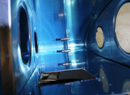

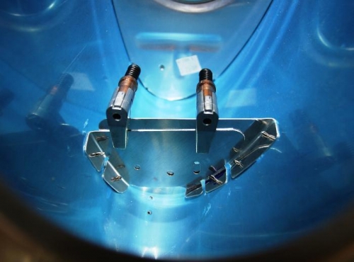

Brief Description:  Preparing for the Stall Warning Kit

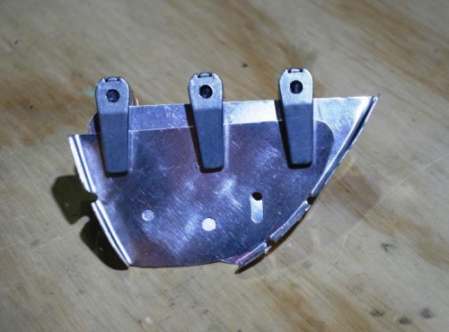

I clecoed the top bracket into place and then tried to cleco the bottom bracket in place but the bottom wouldn't fit until I trimmed the forward and top edges. I carefully trimmed the bracket away a little at a time and continued to retry clecoing it into position until if finally fit. This is shown in Images 1 and 2. You can easily see how much the mounting holes differ. If you look carefully at Image 1 you can see where the two holes to locate the slot for the sensor tab will be. Image 3 shows how the brackets look outside the leading edge.
Modified Brackets Clecoed into Leading Edge Skin Viewed from Side

Modified Brackets Clamped Together Outside Leading Edge
