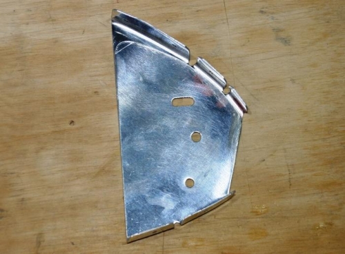

Brief Description:  Preparing for the Stall Warning Kit

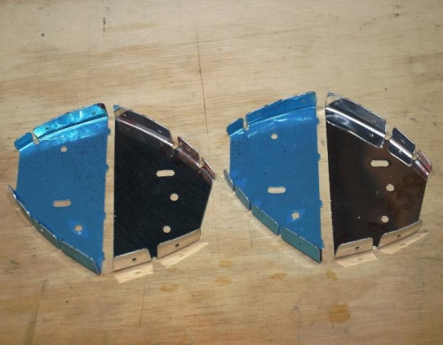

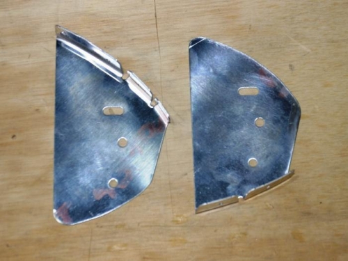

After my attempt to install the original bracket failed I decided to order two more brackets from Vans and cut the bottom flange off one and the top flange off the other so that they could move fore/aft independently. Image 1 shows the parts after they were separated from their RV-9 counterparts. Image 2 shows the two brackets after I removed the bottom flange from the one on the left and the top flange from the one on the right. Image 3 shows the two brackets set on top of each other to make up one complete bracket.
